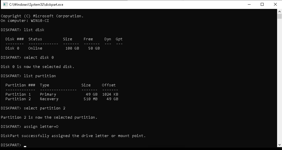

. - Use
diskpart
to find current recovery partition and assign a driver letter(eg. O) to it:
DISKPART> list disk
DISKPART> select disk <the-number-of-disk-where-current-recovery-partition-locate>
DISKPART> list partition
DISKPART> select partition <the-number-of-current-recovery-partition>
DISKPART> assign letter=O

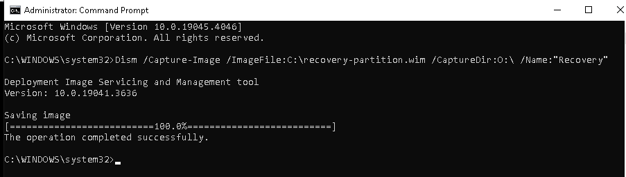

In the command prompt, create an image file from current recovery partition:
Dism /Capture-Image /ImageFile:C:\recovery-partition.wim /CaptureDir:O:\ /Name:"Recovery"

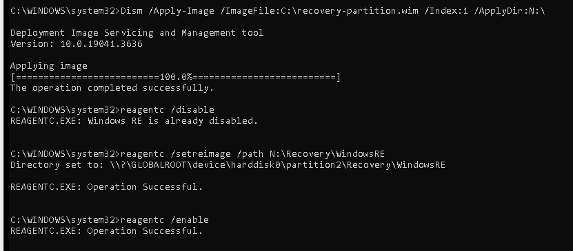

- In the command prompt, apply the previously created image file to the
N:
partition that will become the new recovery partition:
Dism /Apply-Image /ImageFile:C:\recovery-partition.wim /Index:1 /ApplyDir:N:\
- In the command prompt, register the location of the recovery tools:
reagentc /disable
reagentc /setreimage /path N:\Recovery\WindowsRE
reagentc /enable
