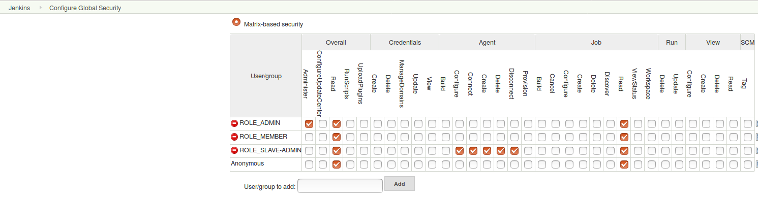

Note: if your Jenkins is > 2.129, please be aware of the following
security hardening :
https://jenkins.io/blog/2018/07/02/new-api-token-system/
As Gitlab will connect as anonymous to Jenkins for hooks, anonymous requires read permission on your project. In Manage Jenkins, Configure Global Security ( or https://ci.inria.fr//configureSecurity/ ), add anonymous permissions to read - overall and read - job in the permission table.
